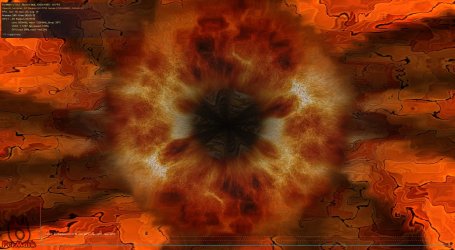

I've run Furmark with the above preferences. It looked all fuzzy (see the attached pic). Should it look like this?

Hello Novbert,
If you look in the upper-left corner, you'll see your FPS is pretty low. Try running at a lower resolution, or running a less intensive test.

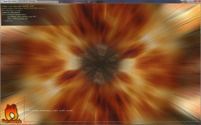

I have a Radeon HD 6850 graphics card that I purchased and installed last week.
Here is a screen shot of FurMark with XtremeBurn-in. FPS are averaging at 13 after 15 minutes.
Here is a screen shot of Furmark with just Burn-in. FPS are averaging at 25 after 15 minutes.
As you can see both shots are quite distorted, is this a good indication that the graphics card is faulty and should be returned?

To be honest, both screenshots seem quite normal. Here are screenshots I just took of Furmark running on my GTX480:
Burn-in:
Xtreme Burn-in:
I don't see any distortion, and your frame rates are within the range, so I wouldn't worry about anything. :)

Hi there,
Here is my last test with Furmark 1.9.1:
Can you please tell me if you see something wrong in it.
Thank you in advance

Hello myzrael,
I don't see any artifacts or anything. It is poor quality in the middle, but I'd think that's related more to the amount of strain you're putting on the card vs. how powerful the card is.

Hello,
I checked your screenshots with mine and i think i have a problem.. it differs a lot
Could this be the problem for the bsods i am experiencing ?
The bsod thread is here
