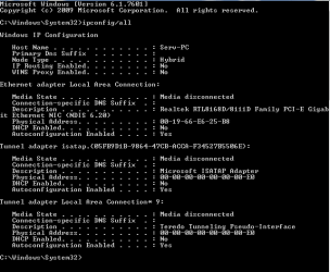

my ipconfig/all
This attachment should show my ip config

No connection at all according to the ipconfig. It looks like something broke the network adaptor or the cable is bad or something. Clearing the cmos isn't a bad idea at this point. If this is a PC there should be a button somewhere on the board for this. No system specs are listed so I can't look that up for you.
A recent system image would come in handy at this point although if it's a board problem that won't help, clearing the cmos might work.
