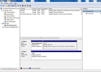

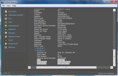

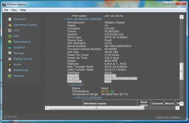

1- before formatting HDD 'speccy' showing discrepancy between size & capacity pictures 1&2 attached (capacity 1678 GB & size 3699 GB).

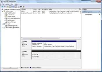

2- strangely after formatting, HDD showing only 1678 GB of space in Disk management (pic3) & i had to format it (GPT using disk management) then use a win7 CD to format it again & restore the entire space.
3- after that whether i format it again from disk management or not it shows the full space (pic4) & it works fine until reaching 2.27 TB of storage!

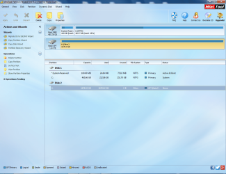

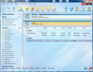

4- minitool shows 1678.02 GB capacity, -2.19887e+12B used! & 3725.88 unused. then after 2.27 TB storage it shows 1678.02 GB capacity, 1678.02 used & 0 unused (pic's 5&6).

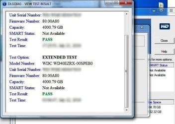

5- performed both quick test & 'complete test' in 'WD data lifeguard diagnostics' with HDD passing both (before, also after writing data to HDD & after it became un-accessible).

  • 1- speccy (before formatting) showing descripancy btw capacity & space! 1.jpg
  • 2- speccy (before formatting) showing descripancy btw capacity & space! 2.jpg
  • 3- 1677.9 GB disk management(should atleast show the remaining space in HDD!).jpg
  • 6- minitool showing 1678.02 GB capacity, 1678.02 used & 0 unused after2.27TB storage.png
  • 5- minitool showing 1678.02 GB capacity, -2.19887e+12B used & 3725.88 unused.jpg

If its sata3 is it on a sata3 controller not sata2?
win 8 32 bit
win 8 32 bit
It is SATA 6Gb/s and if OP is using SATA connection, he should connect it to one of the two SATA 6 ports in the motherboard. I would think the OP is aware of this.
While trying to resolve this problem the OP is well advised to adhere to SATA connection to the motherboard since traditionally people have reported many problems with eSata and Windows 7.
On the suggestion of ThrashZone, I entirely agree that one will be better off with 2TB drives rather than >2TB drives especially with old motherboards. Two 2TB drives is definitely better than one large 4TB drive ( I have consciously avoided >2TB drives throughout.) Here two birds in the bush is better than one that flies :D.

connected to a 'SATA' port instead of 'e-SATA' same situtation
