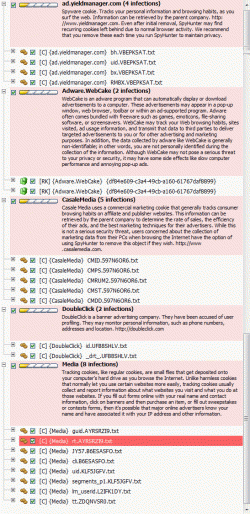

5. I then following the advice on answers.microsoft.com installed "SpyHunter 4" and ran a fast scan.
This found about 66 items under the following headings:
- Babylon Search
- Hola Search
- Advert
- Adware Helpers
- Adware.WebCake
- Atlas DMT
- DoubleClick
- Media
However I then discovered that SpyHunter 4 is not free so I stopped.
What should I do next?

Meanwhile SpyHunter 4 is still finding 21 Threats (and counting) including Web Cake... This may of course be a false alarm but it is worrying.
Now what?

Select Settings;
Select Basics ->Manage Search engines;
Remove unnecessary search engines from list;
Go back to settings. On Startup choose open blank page ( you can remove undesired pages from the set pages link too).
Windows 7 Ultimate 32-Bit & Windows 7 Ultimate 64-Bit
Intel Core i7 CPU 950 @ 3.07GHz
ASUS P6T DELUXE V2
OCZ 6GB (3 x 2GB) 240-Pin DDR3 SDRAM DDR3 1600 OCZ3X1600R2
ATI Radeon HD 5700 Series
OnBoard
WD6400AACS-00M3B0 (640GB SATA )
CORSAIR 850w
NZXT LEXA
Intel Stock Heatsink Fan
Microsoft Wireless Laser Keyboard 7000
Microsoft Wireless Laser Mouse 7000
Do I need to be in Safe Mode for all this stuff?
Fwiw, my screen just went black - but it's a hot day an my PC may have over heated, I'm not sure. So I'm writing this on my laptop (XP) and letting the Win7 PC cool down for a few minutes.
Update:
Okay I've done all that. None of them were still talking about Web Cake (probably because I had already changed them back previously)
Now what?
