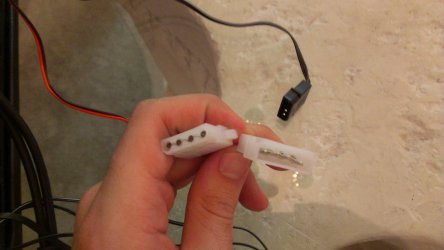

I have 2 cables and i dont know where they go. The first is +P LED which has a connector for 1 pin only. And then i have its friend, -P LED... There is a spot that sais LED- on the board, so thats a given. But where do i put the positive (+P LED) cable? On the pin above or to the left of where i put the negative?

Yea i'm quick to reply i'm still looking at the case with a stupid look on my face and my laptop besides me with the forums up hitting F5 to refresh haha....
But okay...
I have 3 pins on the bottom right hand corner of the area for the Front connections. Two of those pins seem to be labeled "+PWR". The pin to the right of that sais "LED-" ... Which of the three pins to i plug my -P LED and +P LED cables?

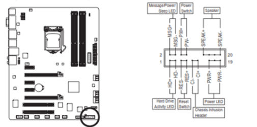

Here is a copy from your Motherboard Manual
They go;HDD Led on the bottom left two pins
Power SW on the center top
Reset switch on the 3rd and 4th pins from left on the bottom
+pwr led and -pwr led go on the 1st and third pins from the right on the bottom leave the second pin empty.
The front panel audio connects to the header just behind the rear panel
It is labelled (12) in the manual
Be careful as there are two types of Audio (AC97 and HD) and the plugs are not interchangeable.
Just a bit of info on the Power led plugs, it appears there was no standard for them and some Manufacturers used a Two pin plug and some used a Three pin plug and by using two single plugs you can use it on both.

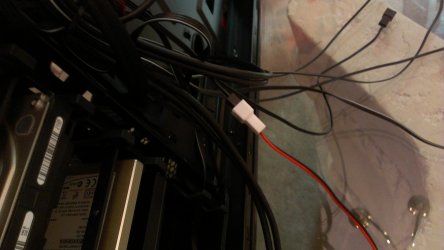

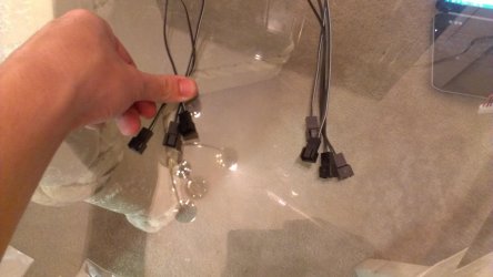

OK Guys.
Frys pretty much did nothing for me. I got home and none of the cables i was having a problem with were connected. At least my fans are working now, which is all they did. At least it was only 20 bucks. I'll be getting that money back soon.

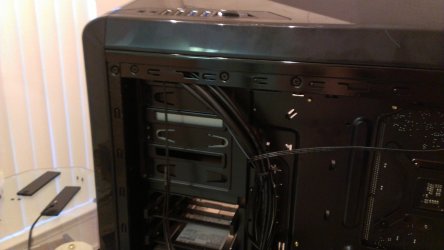

I have extra cabling coming from the top of my case where the fan control, usb 2.0/3.0, audio and mic jacks are. There are a total of six. I do not know where these are plugged in to. I think they plug in to my PSU because there isn't a place on my motherboard for a connection of that type. The guy from frys had to use a Molex adapter to hook a fan up to my PSU. I'm thinking i'll have to do the same with these ones. But what the heck do they do ?
I really wish there was someone reading this that's had experience with this specific case =(
Here is the link to my case and all other relevant info. And yes, i've already submitted 2 trouble tickets.
The Phantom 410 case manual
Link to Phantom 410 Manufacturer page
I just need to know where those six cables go and their purpose. here are pictures of them.

The wires in the left picture appear to be 3 pin fan connectors. They plug into the fans wires. But somewhere there has to be a molex connector to power them. I am not familar with that case, but I am guessing it has a fan controller on it.

Yes, this case does have fan speed control at the top. The cables are all bundled together so i do not know exactly which one of them is the fan speed cabling... i see a cable with a connector that has red black and yellow wheres. There are two connections on one end, and the other picture shows it connected to another cable. one of the connectors has 4 prongs to connect in to something (male connector? not sure what its called) and another with something plugged in to it. The "male" connect wont connect to any of the cables i have on my PSU, so i'm guessing i will need a molex adapter?
The "Female" connect that you see in the picture was connected to the black cable u see on the table in the background.
Sorry if i'm not making sense. I'm kinda of a noob and i'm doing my best to learn. I didn't know that video existed so i am also in the process of checking it out.

The picture of the molex connectors you are showing is of a male and a female connetor. I can't tell for sure, but if they are on the same wire, plug the male connector into a female from your PSU. Some molex connectors have both male/female on the same cable to allow you to daisy chain them together. A female connector gives power an male connector receives power. In the video watch the part where she is showing the front panel connectors. She shows a molex connector that provides power to the fan controller. Then the 3 fan connections that you plug fan wires into. That should be all you need to do to power and control the fans connected to the controller. I hope this didn't confuse you more.
