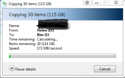

I know the 5 Gbps 3.0 spec is just theoretical?
Hello drtim The actual speed you can expect from usb3 tends to be very similar to sata speeds.
See the attachment
Actual speeds will vary depending on type of data being transferred and types of HDD, SSD etc
It is however clearly faster than usb2 my set up rarely got over 25MB/Sec
I hope this helps

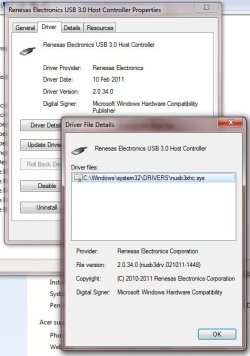

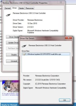

renesas took over from nec, i have a similar nec based usb3 pci-e card, works fine in win7 x64.
you can download the latest win7 x86/x64 drivers at:
http://www.station-drivers.com/page/nec.htm
my 8gb usb flash drive runs at almost 3x what it does in a usb2 port.
edited: noted 2.0.34 is latest, i also just updated mine to that from 2.0.32 within the last few minutes. added new screen shot...:)
