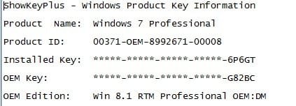

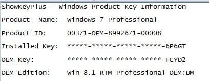

Got a number of 1 year old HP office PCs from a closed call center. The units were reset back to factory by some local IT guy by the seller. They have Win 7 pro on them. They all have a different OEM key for Win 8.1.
Is it normal to have all the PCs have the same "Installed Key" which I assume is for the Win 7 OS?

What I have seen is that, despite different COA key, the installed key is the same.
What I understand is that the computers came with Win 8.1 Pro and it was downgraded to Win 7 pro. Is it right?

Hi Busaboyz,
if you run this tool
http://go.microsoft.com/fwlink/?LinkID=52012
you will be able to tell if the keys gonna come back Genuine for a W7 install.
LOOK AT LINE 7 first -- windows product id type
if its >> 2 <<
then the lines above it will read
74T2M-DKDBC-788W3-H689G-6P6GT -- product key
XXXXX-OEM-8992671-00008 -- product ID
THE ABOVE ARE LOADED ON THE COMPUTER AT THE FACTORY
and are used on every HP W7 PRO.
Which is what you are seeing
The COA (sticker) code is unique to every computer. -- basically a spare key
note W8 computers only have a small hologram sticker on them
So if it was originally shipped with W8 -- NO COA sticker
if you post te results of one of them i will be supply more detail.
As they were reset by the same IT guy ALL the reports should be identical
There is no sensitive detail on them so just post it.
