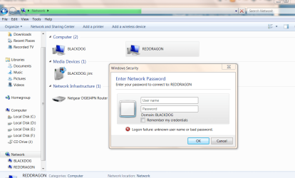

Hi there
I don't know much about domains -- but "Bog standard" file sharing between W7 and W2K3 (32 bit) isn't a problem provided firewalls set OK and permissions on target drives set OK.
I find also RDP'ing to a WK3 server on a LAN is fine -- simplest way to do it too.
I haven't tried this over a corporate VPN but on a Local LAN its fine and speed is more than adequate.
Check your LAN speed as well - some corporate LANS are really SLOW depending on how the connections are wired - especially if the server has to go through more than one router.
on a standard 100mbs LAN its fine.
Here's the login screen from W7 to W2K3 server and then the shared disks displayed in W7 -- no problems
Cheers
jimbo
