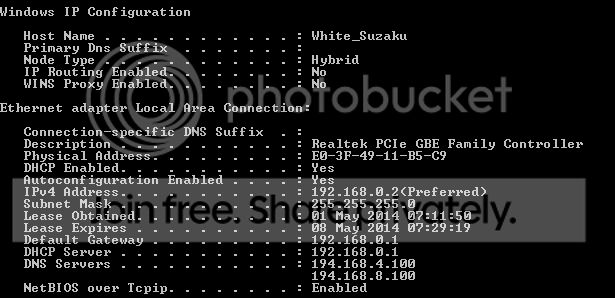

Just as a precaution it would be good to check your IPconfig as it may indicate a potential cause of this issue.

You IP config seems fine to me. Although I could almost guarantee you will still get the DHCP errors if you wait long enough. Windows will try and renew its DHCP lease after the halfway point that it has had it for. If it can't do that then a log is made. Since you gave it a reservation the lease time has gone from about a day to 8 days. If you wait long enough the errors would probably continue.
