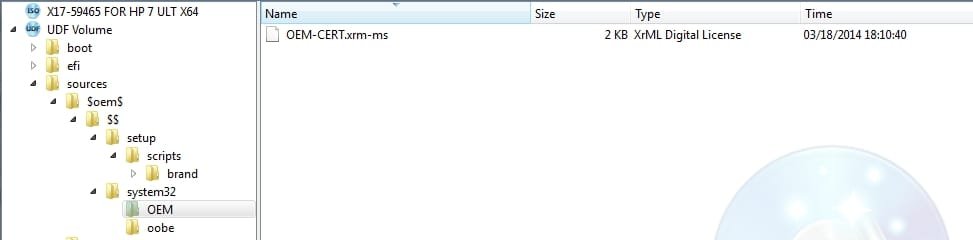

Just had a look at the iso from archive.org
The boot image is wrong so the iso won't boot under 64 bit efi
could extract the iso contents to usb stick instead. It looks like it has the xrm-ms file
might chuck it on an hp machine that is lying around and see if anything else is wrong with it.

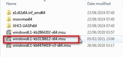

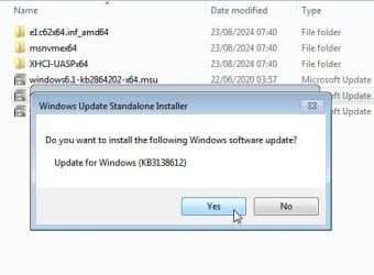

If wanting to run windows update, Install this update manually first
:ar: https://www.microsoft.com/en-us/download/details.aspx?id=51212
after reboot run windows update . Took 6m30 secs of searching to offer these

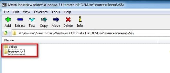

You could apply the image from the install.wim and then copy the contents of the $oem$ folder to the windows directory that has just been applied before booting into it.
copy
\sources\$oem$\$$\setup
and
\sources\$oem$\$$\system32
into the just applied windows folder.

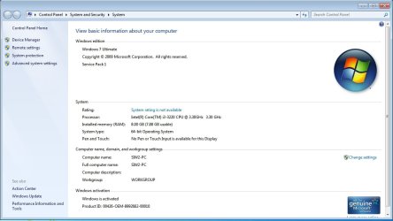

if you run the tool i referenced it will tell me if SLIC table and the w8 marker are present, as well as the type of Ultimate iso you have
from siw2 system screenshot i can tell you it refers to a factory installed HP W7 Ultimate OS install:D;)
