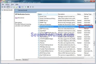

Type ser in Search, click Services in the results. See if you have the entry below and try to start it.

We've already established the problem isn't with the SPPSVC settings :)
that's what all the SC queries were about.
