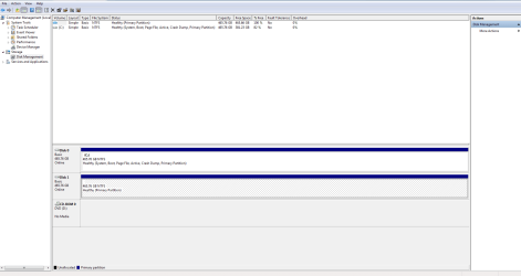

Sorry for the delay in replying, been very busy. Okay so everything appears to be working fine (all drivers/utilities installed and running fine etc).
Here is the disk management capture: Capture.PNG
Windows 7 Home Premium 64bit.
It looks like the PC originally shipped with two 500gb hard drives, possibly in a RAID array. But it was reinstalled only to one of the hard drives, placing the boot manager on the other one. I'm not sure how you could have missed that you were installing Win7 to one of two 500gb hard drives, or that after you created and formatted partitions it showed that it had placed the boot partition on the second hard drive. Did you follow http://www.sevenforums.com/tutorials/1649-clean-install-windows-7-a.html ?
This is OK now since Win7 doesn't much like RAID anyway so you're better off with the OS reinstalled to one hard drive. Now you can format the second hard drive as a data and storage drive to save your Win7 backup and a backup image in case the first hard drive ever dies.
But first you must move the Boot Manager to C. I would use EasyBCD (click Download - no Name or Email required) following these illustrated steps to move http://www.sevenforums.com/tutorials/209885-bootmgr-move-c-easybcd.html.
Once that's done mark the System Reserved partition Inactive and then delete it in Disk Mgmt, repartition it as a data drive: http://www.sevenforums.com/tutorials/197157-partition-mark-inactive.html
I followed a different tutorial. After I formatted the partitions and had to choose where to install the OS, I had 2 choices of either 500GB drive, so I arbitrarily chose the top one (Disk 0 IIRC).

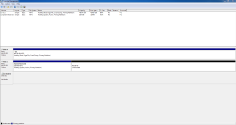

Okay so I followed the steps up to until creating the new partition, created it and quick-formatted as in the guide.
However when I try to back-up/system image it doesn't see the hard drive available (likewise in My Computer I can only see C:\ and my DVD drive). Any suggestions?
See the image attached, Volume 2 is the relevant partition I believe.
Please post back another screenshot of http://www.sevenforums.com/tutorial...nt-post-screen-capture-image.html#post2261610.

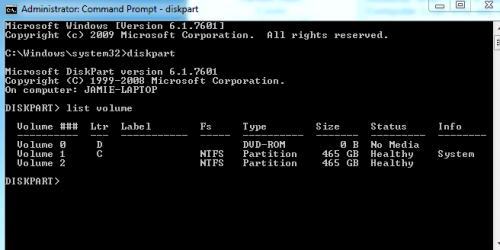

It appears the new partition you created on Disk1 after moving the Bootmgr to C and deleting System Reserved partition does not have a drive letter, as it must to be seen in Explorer: Drive Letter - Add, Change, or Remove in Windows 7 - Windows 7 Forums
Here's the picture I'll just wait for you/somebody to confirm before I add the drive letter or whatnot.
Yes, you need a drive letter. ;)
Thanks for clarifying this ;)
Anyway all issues seem to be resolved now, thank you very much everybody for your help, lovely community!
