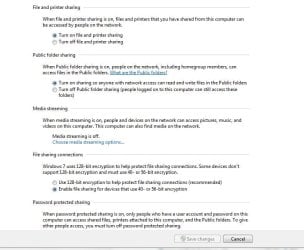

Here are my settings for a business network workgroup (not Homegroup).
I can have 12 to 16 computers on network at any one time (XP, 98SE, 2000, Win7 32bit & 64bit)
I run AVG Free version on all computers.
You do have " Turn on Discovery " checked, correct ?

yes I have the same settings as you.
I have 128 bit for security no passwords
