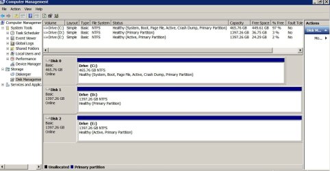

To check this please post up a screenshot of your full Disk Mgmt drive map with both drives connected, using Snipping Tool in Start Menu.

Looks ok but I would use Diskpart from C to mark E Inactive: Partition - Mark as Active (Method Two)
