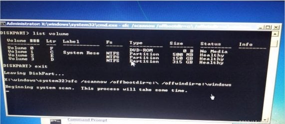

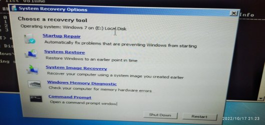

I don't get it why it says operating system is on local e disk, i have scanned this 4 times now and still says there is no problem, i a am still trying though, until it says something different
  • OS
The Windows drive letter can often be different at boot, while it's always "C" while running.
Your windows partition will be either e or d according to your screenshot.

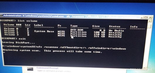

I just typed this and restarted for 5 times, says same thing, any suggestions?
because you are in ramdisk (x:)
If the windows partition shows as E: when booted into winpe, then the command should be:
SFC /SCANNOW /OFFBOOTDIR=E:\ /OFFWINDIR=E:\WINDOWS
