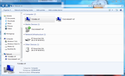

XP shows on my network, i can get through to XP and see all of the shared folders there.
I can access and modify \\Toshiba-xp\SharedDocs, and the printers.

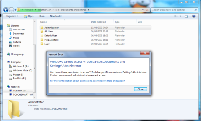

I can access \\Toshiba-xp\c but when i try and access the Admin or Lucy account in Documents & Settings i get this; i get the same message trying to access any other folder in \\Toshiba-xp\c

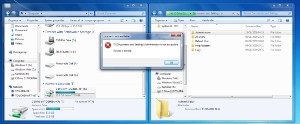

I believe this is normal. It would be the same if Lucy were logged in and tried to access the Admin Docs & Settings or yours ie: Access Denied!!!. When you first setup user accounts in XP you can choose to make them private (already mentioned by sup3rsprt) or shared. Shared user accounts will have a folder "My Doc Folder" for each user visible on each user account's explorer.

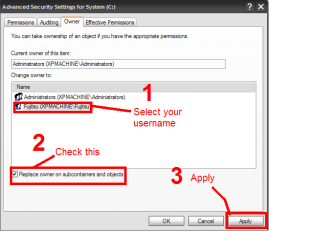

Go to partition where you have shared files(you can do this on all),right click/properties,go to security tab/advanced/owner tab and do like on screenshot:
Hope it helps!

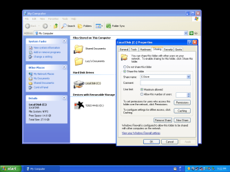

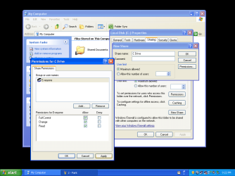

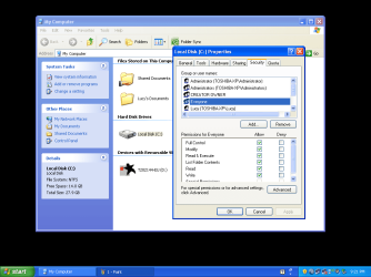

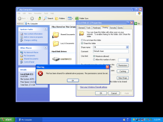

Here's a few screenies from admin account on XP;
Simple file sharing has been disabled from the off really.
Still no go after the new share was set too :(

Entries in the ACL will take precedence over share permissions. Just because the Everyone group is allowed access to the C share, it does NOT mean the Everyone group can access C:\Documents and Settings\Administrator.

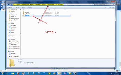

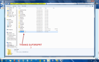

With admin credentials from XP;

Here's mine:
Administrator
Administrators
SYSTEM
Full Control on "This folder, subfolder, and files"
(You can see that info under the Advanced button)
I shared the C: drive on Windows XP
Then from Windows 7, I mapped the C: drive as Z: in My Computer using administrator credentials that exists on the XP machine.
I am not getting any "Access Denied" messages when browsing any of the folders inside Documents and Settings.
My Windows 7 settings are in default state. I have not changed a single thing dealing with file sharing.

:thumbsup: JOB DONE!!!!! :thumbsup:
I used cacls on XP
I then made sure that my settings matched up to yours. (I set my MND to T)
Just for good measure i added an 'Everyone' entry to the ACL with Full Control to the 'major' folders in needed access to.
My complete access to the XP lappy & Remote desktop connections are now resumed.
Still bemused as to why that it changed over night. :confused:
You sup3rsprt, are a true gent. Your ongoing help tonight (23.29 now) has been greatly appreciated. I hope to help you sometime in the future!
Have some rep. on me :D
