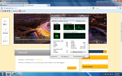

If I keep my Windows Task Manager opened to performance & memory usage when I try to do stuff on the laptop, it shows me 0% CPU usage when the laptop has a `crash moment`. It simply crashes (stops doing anything) while CPU is 0-3% used and RAM memory around 700 Mb.
I attached a photo with one of this `crashes` where I wanted to visit a page and Firefox was just Not Responding while CPU was at 1% usage.
