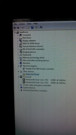

Here's a shot of what Device Manager is telling me:

It does not look like Windows is seeing the wireless network adapter - so there is no reason to try and install drivers for same. It might be best to buy a new wireless network adapter.

I've already purchased one. Should be here in a day or two. I'll keep you posted after I install it. Thanks for your advice thus far.

I replaced the Wireless Network Adapter Card (a little bigger than a postage stamp) That did the trick. Restarted the machine and it automatically downloaded required drivers. Good to go now. Thanks for your advice.
