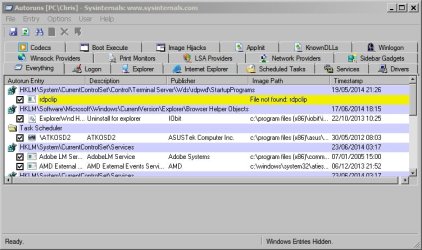

Autoruns will not read rdpclip and report that it's missing. That's because of the way it parses the data. I don't know what version of Autoruns you're using but try the latest version if you're using an old one. You should leave the entry in Autoruns alone.

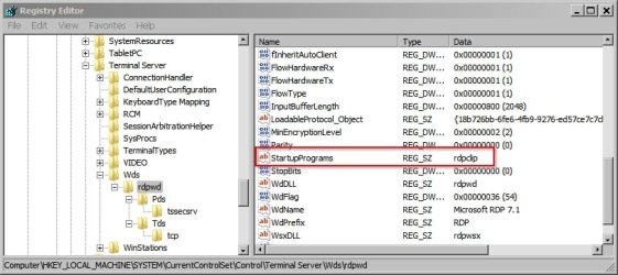

Check your registry here:
HKEY_LOCAL_MACHINE\SYSTEM\CurrentControlSet\Control\Terminal Server\Wds\rdpwd
Look for the following and if you see the same rdpclip entry then it's fine.
Screenshot from Autoruns (my machine)
It's nothing to worry about unless you want to use remote desktop and it's not working!

rdpclip missing
Some further info here:
farfel - rdpclip.exe - Program Information
Also as far as I can work out the actual rdpclip.exe file is not supposed to exist in Windows 7 Home Premium as it can't be used as a Remote Desktop Host without implementing a hack.
Also see this post - I believe that it's the correct explanation!
