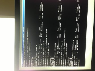

Ok, I was doing this wrong I think... Which one should I be making ACTIVE and please tell me the order of steps following me making active.. see screen shot.. 1 is active currently....

It is ACTIVE already I think?
the 100MB partition is "System Reserved" I assume?
11GB partition is some reset to factory settings partition?
anyway the ACTIVE partition is the one you boot from. It has the bootsector that loads bootmgr. bootmgr loads the bootmenu and loads win7. All is working fine so why change the ACTIVE partition???!!!
Unless you expect a virus in the bootsector or bootmgr.

11gb is the c: windows, where my user account is... Yea, the 100mb is the hp recovery partition

100 mb is not HP recovery but is the correct partition to mark active as you were first told. You were to confirm it is active to run Startup Repair x3. Have you done this yet??
Sorry, no. I did it wrong... I'm going to try it right now again. Mark the 100mb partition as active. Now, can I just hit f8 to get to the repair tool installed locally on the machine, instead of using the cd I burned with the repair on it. Does it matter? I was using the cd most of the time, and realized the repair can be found by hitting f8 on my system with no CD needed...
