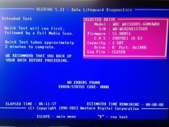

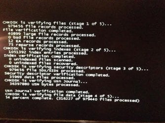

Disk Check is checking your hard drive which absolutely needs to be done to completion to know if the file system needs repair or is irreparable. It should take a long time for a 1tb HD, but if it takes days then this points firmly in the direction of your HD or the file system residing on it.
The next step is to confirm the HD's status using the maker's HD Diagnostic extended CD scan, to know with certainty whether it needs replacement.
If the HD checks out then your choices are to work with the experts here to clean up an apparently seriously infected OS, or to cut your losses, back up your files to quarantine (for scanning with Malwarebytes, your AV and SAS before reimporting later) to delete all partitions during a booted Clean Reinstall - Factory OEM Windows 7.
This has the added benefit of giving you a perfect install replacing the worst possible install one can have which is the HP pre-installed Win7 larded with the worst load of bloatware in the industry, including duplicate utilities that interfere with better versions built into Win7.

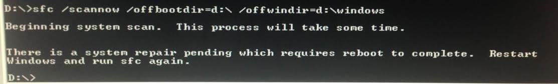

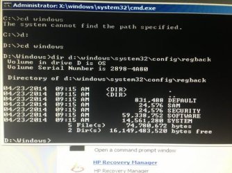

In addition to the specialized steps you've already been given to clean up your known infection, once it is cleaned I'd proceed with the steps to check System files and then try to repair the boot as given in Troubleshooting Windows 7 Failure to Start.
