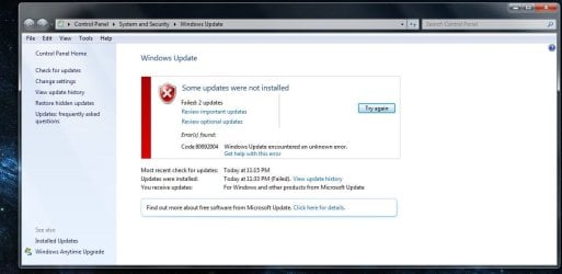

Trying to get the last of the security updates, before 2023.
Do remember them failing in 2019, conveniently before the EOL, and Windows 10 up0grade fiasco.
I think i just disabled them around 2019 or so, because some would fail, some would install, but cause issues.
Just reaching out here to see if anyone has successfully installed all the important security updates.
Iam running MSE, and need the critical updates for the virus/maleware definitions. Already had that issue with the update warning appearing on the shutdown button. So had to disable them.
system specs: Windows 7 SP1 64bit/IntelCorei5-2400/3.10ghz/8gigRam.
Attached a screen shot of failed/installed updates.
Thanks For Your time.

Guess it/they never got installed. May have to manually dl it.
Weird that the critical one for the antivirus security essentials did though.
Just dont want to make things worse. Thats why i stopped updating awhile ago.

The two SHA-2 Code required ones do not have the same status. KB4490628 being a Servicing Stack Update and being an actual prerequisite, too, makes it hard to be offered at Windows Update.

Why would you not want to install KB4490628, but want to install KB4536952? It's 4490628 missing that causes those later ones to fail.

Oh OK. Didnt know that. So I need to manually install KB4490628, then the rest should install fine right?
- - - Updated - - -
- - - Updated - - -
Should i reset windows update in cmd prompt or anything?
I saw online and some Youtube tutorials there is a certain way to do it.
Some advice would be helpful.
Thanks

It's actually as easy as dowloading and running the msu file.
Microsoft Update Catalog
The main issue you have with KB4490628 is its not being readily available at Windows Update. Windows Update will insist on offering it after everything else is installed (or hidden), while something else will insist on 4490628 being installed already.
It's just a regular update otherwise.

Again, if you don't mind installing KB4536952, there's no reason to mind installing KB4490628.

Of course not. Would you feel more comfortable with installing it from Windows Update? Hide every important update Windows Update offers until KB4490628 appears. After installing KB4490628, unhide everything previously hidden.
