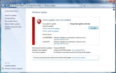

Solved Windows Update Error, Error Code 80070643, Code 9C57
qpuser412
2:27 AM
12
Computer model: Panasonic Toughbook CF-31
OS: Windows 7 SP1
Processor: Intel Core i5-2540M CPU @ 2.60GHz 2.60GHz
RAM: 4 GB (3.89 GB usable)
System type: 64-bit
CBS Log
CBS.zip - Google Drive
I ran the SURT tool Windows6.1-KB947821-v34-x64.msu.
Ran fine, no problem.
Ran sfc /scannow
"Verification 100%"
"Windows Resource Protection could not perform the requested operation."
Also ran
Malwarebytes
JRT.exe
Adwcleaner
Hitmanpro_x64
I still get the "Windows Update Error, Error Code 80070643, Code 9C57"

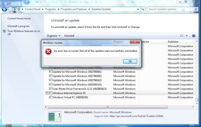

Ok, I was not able to uninstall IE 10 (Version 10.0.9200.16660).
I opened MS Excel 2007 and it opened fine, it did not need to be validated with Microsoft.
I tried to run that IE11-Windows6.1-x64-en-us.exe and it wanted me to download 6 prerequisites.

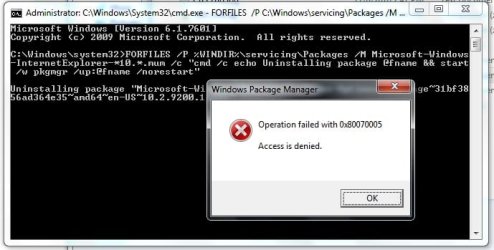

Hi Qp,
try this from an elevated command mode please, (copy/paste)
FORFILES /P %WINDIR%\servicing\Packages /M Microsoft-Windows-InternetExplorer-*10.*.mum /c "cmd /c echo Uninstalling package @fname && start /w pkgmgr /up:@fname /norestart"
Roy
E5300 dual core
medion MS7366
3gb
avixc
n (isp resticted to 72)
mse/pands
palemoon
Windows Package Manager
Operation failed with 0x80070005
Access is denied.
OK

Hi Qp,
I cant source a replacement file for the IE10 error.
I take it that the six failed updates are the pre-requisites for IE11?.
As your using Firefox,
you could turn off IE in >>progs/features>>turn features on/of (top left) new window opens uncheck IE, (note this may not work as its corrupt)
The other option is a repair install with no loss of data.
Roy

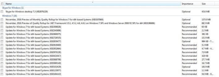

A repair install will not help. Backup your data and do a clean install. What you are trying will never make it right.
After installing windows you install the 2 updates found in this thread.
Windows Update will not update and I've tried multiple fixes
After that you install only security updates, then you go over the description of each and every important/recommended update to see if you want or even need it.
I have never installed any updates while installing Windows, if you don`t have the ethernet drivers installed it`s impossible anyway, no reason to even try. (I understand you are already in windows)
3 recent installs done in the last 2 weeks, no windows update issues at all, and a perfect sfc, and these are the updates you can skip and hide, W7 is now a snap to install again.
