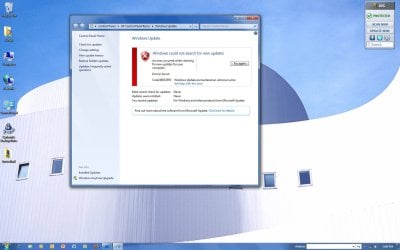

I just completely reformatted my computer after a suspected malware attack.
The first thing I tried after reformatting and doing a clean install of Windows 7 Professional 64 bit edition was to run windows update. I received the error code 80072EFD. This is before I installed any software, firewalls, or antivirus programs. I also get this same error when trying to activate windows or office, or when trying to set up Microsoft media center.
I do have internet connection. Both firefox and internet explorer work perfectly fine.
I have been in contact with microsoft, but nothing has worked so far. I thought I would see if anyone here had any ideas.
Here are the troubleshooting steps I have already done. Please read through these before posting as you can see I have already tried a lot of things!
1. Waiting 15 minutes and trying again
2. Restarting the computer
3. Adding windows update websites to the internet explorer exceptions list: http://*.update.microsoft.com https://*.update.microsoft.com http://download.windowsupdate.com Microsoft Support http://update.microsoft.com https://update.microsoft.com
4. Verifying internet connectivity (internet works fine)
5. Tried it with Windows firewall on and off. No other firewalls are installed.
6. I tried this before any anti-virus was installed. I have since installed AVG free and tried again both with it running and disabled
7. No software accelerator programs are installed
8. windows update is not using a proxy server. Tried resetting anyway. "Direct Access "
9. Update firmware on router
10. Pluging in directly to modem
11. Have windstream reset my internet connection
12. Update BIOS to most recent version
13. Clean Boot

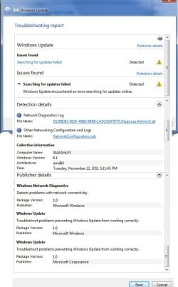

14. Download and use MicrosoftFixit50202 - ran in aggressive mode; Ran System Update Readiness Tool for Windows 7 x64
I'm attaching the windows update log and sur below as well as some screenshots of the windows update.
(PS - I know there are other forums with this issue, but I have read many of them and none of them seem to list any information I haven't already tried.)
Please, any ideas would be appreciated!

The system is failing to connect and pull down the initial XML file required for connection to the proper WU servers.
What happens if you try and pull it down manually?
http://www.update.microsoft.com/v9/windowsupdate/redir/muv4wuredir.cab
I suspect that this is a problem with a network firewall/NAT translation.
How are you connected to the internet? Through a NAT router, or what?
please post the results of IPCONFIG /ALL from an elevated Command Prompt.
also - try
PING update.microsoft.com
(It will time out, but do you get the proper DNS response?)
"Pinging www.update.microsoft.com.nsatc.net [65.55.184.152] with 32 bytes of data" - or close to it.

Thank you Noel for your suggestions. Before I had a chance to try it though I was able to resolve the issue.
I think I got one of those DNS changing viruses before my computer reformat. When I reset both the router and modem to factory settings, reset up my wireless network, and changed the usernames and passwords for both the modem and router I was able to access the windows update servers.
I can't believe that after everything I tried I missed one of the easiest troubleshooting tasks!:confused:
Thank you again for your help!
