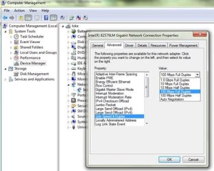

Hello,
What type of ethernet adapter do you have? Is this a Gigabit? You my try changing the Link Speed and Duplex.

Thanks for the response. Yes it is gigabit, I'll give that a try, mine from memory is on auto negotiation. I don't want to jeopardise my gigabit NAS transfer speeds so should I be selecting the top one or the one highlighted in the screenshot? Unfortunately I then have to wait 24 hours before booting again to see if that worked.
Cheers
