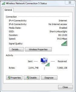

I have a new dual band wireless-AC router (Linksys EA6300) and just installed an Intel AC 7260 wireless card in my laptop. The wireless network I am connected to indicates that it is a 802.11n connection, but in the Wireless Network Connection Status it only shows a connection speed of 54mb/s. The router is capable of 300mb/s in the 2.4ghz band and 867mb/s in the 5ghz band. Using inSSIDer to examine the networks, it shows that when I'm connected to the 5ghz network it has a max rate of 450mb/s.
I have tried everything I can think of and have searched and searched to no avail. If my router is an AC router, and my wireless card is an AC card, why is my connection speed limited to 54mb/s?
I also have another computer with a wireless-N card and the connection speed is also limited to 54mb/s on that computer too.
I've attached a screenshot showing the connection speed.

Thanks for trying, but I've looked at all that already and everything looks set up correctly. The firmware on my router is the latest firmware.

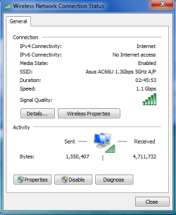

Ideally you should be seeing something similar to the status speed in the picture when using 5Ghz AC, this is 35 feet from access point to antenna but it's open space which is how the 5Ghz frequency is meant to be used.

Good news!!! In the router settings I turned on "Media Prioritization" and enabled WMM Support, and changed the 5ghz band to "AC-Only" and "80ghz" and I am now getting consistent connections speeds of 500+mb/s and I've seen it go close to the max of 867mb/s!
