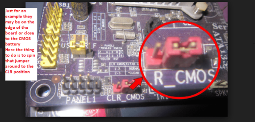

Mate samuria made a good point and to clear the BIOS you need to either jumper it on the board or simply take out the battery and leave for a short while and then slip the battery back in.
