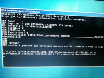

You'll have to excuse any shortcomings I have with my computer literacy. The other day my laptop slowed to a crawl so my wife hard-booted it. When I restarted it, it brings up a screen that says:
Windows Error Recovery
Windows failed to start. A recent hardware or software change might be the cause.
If Windows files have been damaged or configured incorrectly, Startup Repair can help diagnose and fix the problem. If power was interrupted during startup, choose Start Windows Normally.
(here I have two choices)
Launch Startup Repair
Choosing either selection takes me to the same command prompt screen (see attached pic).
From here I cannot type anything in the command prompt. I've tried pressing F8 at startup and selecting repair computer, but I always end up back at the command prompt after Windows tries to start.
Does anyone have any suggestions?
Thanks,
Jay

X:/ is usually the media you are using to recover your OS. That is possibly not a command prompt but a message window. If you have the installation disk or thr recovery disk, boot from that, at the first screen hold down shift and press F10 for a command prompt. If you have not made a recovery disk, you can make one from any computer running the same version of Windows 7 sa you are using. If you are using home premium X64, ant computer running that OS can make a repair disk and be used on yours. Just go to control Panel, back up your computer, and select create system repair disk from the left column. You will need a CD. It appears from that message it cannot find the OS hard drive.

Thanks for the replay. OK, I created a repair disk. Things seem pretty buggered up. I can't get F10 to work from startup (it just takes me to the black "Window Error Recovery" screen). The only way I could access the disk is to press Esc at startup and F9 to access "boot device options" and select "Internal CD/DVD Rom Drive". I did this with the disk installed and it seemed as if something was happening, but then it brought up the windows 7 screen (blue with the little bird on it) and just froze there (mouse pointer worked but that's it). I left it for 4 hours, but nothing happened. So I tried booting again from the DVD, but nothing happens. It just takes me to the "Windows Error Recovery" screen again.

On your first post it appears that the recovery could not find a hard drive it was looking for. Do you have 2 hard drives. Can it be possible that your hard drive went out? If that is indeed the case, the disks won't be able to help. If it is just a startup problem they could very well help.

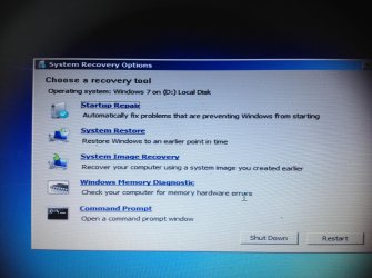

How would i do this in a laptop without disk drive? I got the same scenario as Fishersfinder2000 After sitting on more than an hour standby from a message box that is on repair fix..it shows eventually the details and end up "bad hard disk" ...i click the other recovery option button and ended up at this message:
(See photo) which recovery tool shoul i clck?
Samsung np530u3b
Windows 7 home premium 32 bit before i tried w10 (64bit) and back to windows7
Hitachi HTS545050A7E380
Mozilla/googlechrome
I have no restorations points when i tried the button...so i tried memory diagnotics...with this "developmental" new pop message as compared a month a go...can this meant reformat is an option rather than completely replacing the hard disk?
