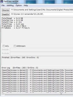

Using FastCopy, a large (and seemingly miscellaneous) quantity of the files end up not being copied, with some of the following errors appearing in the FastCopy log:
OpenFile(Access is denied.5) : F:\Documents and Settings\All Users\Documents\filename
FindFirstFile(Access is denied.5) : F:\Documents and Settings\LocalService\*

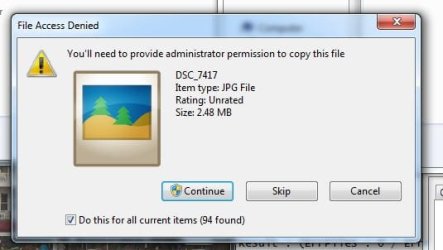

If I browse the HDD, some of the files are not displayed properly (e.g. the thumbnails of photos don't show previews of the photos). These files seem to be in alignment with the files listed in the Fast Copy log as 'Access id denied' However, if I try to copy these files via drag and drop, I can, but am presented with a dialog box of "You'll need to provide administrator permission to copy this file", which depending on the size of the folder appears at what seems like an arbitrary point in the copying process. I click OK and it then copies the files without incident (via drag and drop). Then if I right click and select properties for both the source and destination directories, they don't show the same size. Upon looking further, I see that the files have been copied, but performing right click & properties on the destination folder misreports the folder size. I was able to verify this by both opening the destination folder, ctrl+A on the files then right click/properties and comparing it with the source and find they're in alignment. I can also verify this by creating a new folder, moving the contents from the previously mentioned destination folder into the new folder, right click on the new folder and select properties. Then the sizes match up.

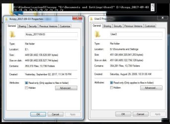

Using XCopy I compared the source and destination and they don't match up. Attached are both the comparison screen captures as well as a screen capture showing what I typed in the CMD window.
Since some of the files were indicating 'You'll need administrator privileges to copy this file', might I want to leave out the -x part? From Xcopy Command - Examples, Options, Switches, More I also want to make sure I maintain any ownership and audit settings in the files I'm copying

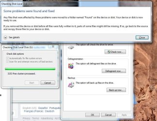

Update: I ran CHKDSK on the HDD
For files which are copying OK, it shows a user name ending in 500 and in some cases User\Administrator; For files which it prompts me to take ownership when I try to drag and drop, it shows a user name ending in 1004. If I change the ownership of one which possesses the characteristics of the latter to either Administrators (User\Administrators) or User (User\username), the file still won't transfer without requiring me to respond to the 'take ownership' dialog box. There doesn't seem to be an option for me to change the owner to the name ending in 500.

I'm still looking for a robust copying tool which will copy all files from a set of directories to an external drive. I've tried numerous things such as XCopy, Robocopy, FastCopy as well as a few others - and none of these can be counted on to copy all the files. I then have to run Total Commander or right click (and select properties) on directories in both the source and destination to find the culprit files. In the most recent instance of using XCopy, I was able to find a culprit file using the right click method and was then able to simply drag and drop it in the destination directory. It seems as if it didn't copy because of a long file name. But why would it copy easily in drag and drop and not in XCopy?
