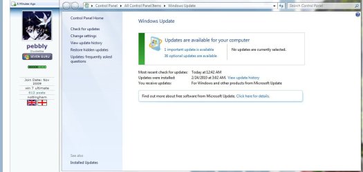

Have you run Windows Update to check for Microsoft updates ?
