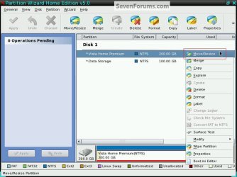

1) Right click the OS partition you want to shrink and click "Move/Resize".
click any image to enlarge

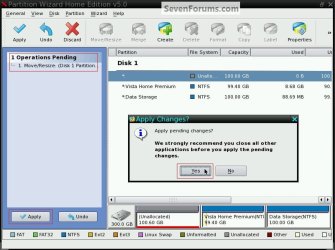

2) In the dialog box that opens click and hold to drag the left slider to the size you want to shrink the OS partition and click ok.
If you are not satisfied with the size you set and want to re-do it or want to cancel the operation all-together, you can click the "Undo" button to remove the current setting before you click the "Apply, Yes" buttons but not after, once the operation has started it is too late go back.

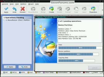

3) In the left pane "Operations Pending" column click Apply then Yes to the 'apply changes' conformation dialog box.
4) You will get a progress graph, when it finishes click ok to the successful box.
This could take quite a bit of time depending how big the Operating System and the amount of personal data including the installed programs/apps there are, just be patient and let it complete.

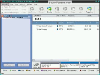

5) It is absolutely necessary to boot back into Windows after this step has completed so that Windows can absorb these changes to the system volume.
Remove the PWBD from the ODD and at the upper left corner at "General" click "Exit" to end the Partition Wizard program and restart Windows.

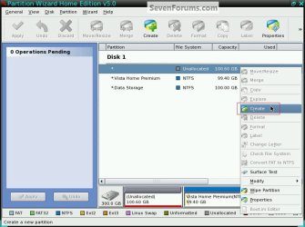

1) Right click the new space created in the previous Step One and click "Create".
2) There's no need to add a "Label" to it yet since that has to be done again in the next step, make sure it's a "Primary" and that "None" is selected for "Drive Letter" and click ok.

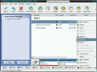

3) Now right click the new partition and click "Format".
4) In the dialog box that opens give the new partition a name at "Partition Label" so it is easily identifiable during the Windows 7 installation (it can be anything you like) make sure the "File System" is still "NTFS" and click ok.

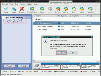

5) When it is as you like, in the left pane "Operations Pending" column click Apply then Yes to the 'apply changes' conformation dialog box then OK for the final 'successful' box.

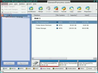

6) It is just as necessary to restart Windows after these steps as it previously was, to let the OS accept these changes to the system volume.
Remove the PWBD from the ODD and at "General" click "Exit" to close the PW program and restart Windows.

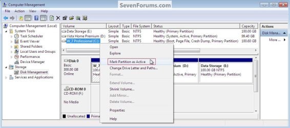

You will need to mark the new Windows 7 partition as "Active" so that the repair procedure will know where you want the new system volume, (the partition the boot files that are needed to start Windows are stored on), then you will need to run 3 separate startup repairs with a system restart between each repair so that Windows will create the new boot files to the new "Active" location.
