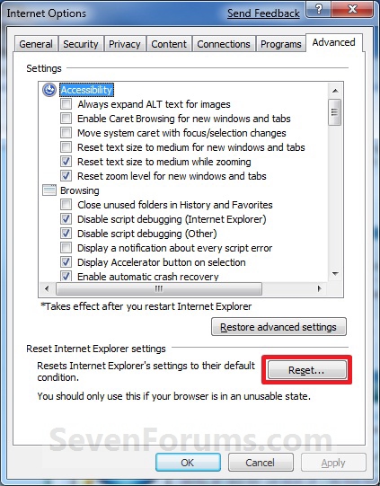

    4. Click/tap on the Advanced tab, and then click/tap on the Reset button. (see screenshot below)
