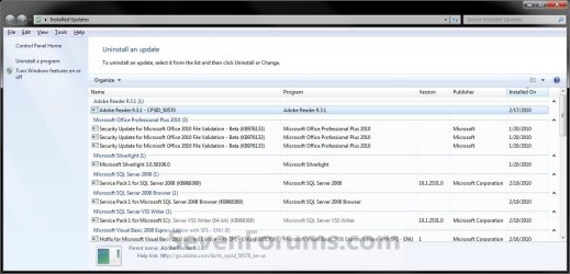

This will show you how to create or download a Installed Updates shortcut to view or uninstall a Windows Update. You can also Pin to Taskbar or Pin to Start Menu this shortcut, or move where you like in Windows 7 for easy use.
EXAMPLE: Installed Updates

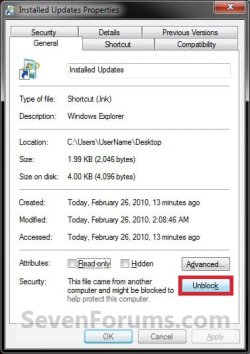

4. Right click on the Installed Updates shortcut, and click on Properties, General tab, and on the Unblock button. (See screenshot below)
NOTE: If you do not have a Unblock button under the General tab, then the shortcut is already unblocked and you can continue on to step 5.
