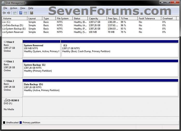

To Change, Add, or Remove Drive Letter in Disk Management
1. Press the Windows + R keys to open the Run dialog, type compmgmt.msc OR diskmgmt.msc, and press Enter.
2. If prompted by UAC, then click on Yes.
3. In the left pane of Computer Management, click/tap on Disk Management under Storage. (see screenshots below)

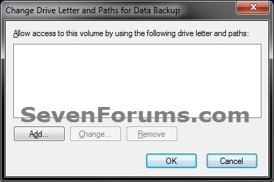

6. To Add a Drive Letter
NOTE: This is to assign a drive letter to a drive, partition, or volume if a drive letter has been removed or does not already have one assigned to it.
A) Right click on a listed drive, partition, or volume that does not have a driver letter that you want to add one to, and click/tap on Change Drive Letter and Paths. (see screenshot below step 5A)
B) Click/tap on the Add button. (see screenshot below)
C) Select (dot) Assign the following drive letter, then select an available drive letter from the drop down box, and click/tap on OK. (see screenshot below)

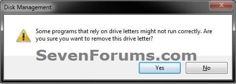

A) Right click on a listed drive, partition, or volume letter that you want to remove the drive letter of, and click/tap on Change Drive Letter and Paths.
B) Click/tap on the Remove button. (see screenshot below)
C) Click/tap on Yes to confirm removing the drive letter. (see screenshot below)

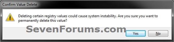

A) Right click on a listed /DosDevices\(drive letter) (Ex: /DosDevices\D: ) that you want to remove the drive letter of, then click on Delete. (see screenshot above)
B) Click/tap on Yes to confirm the deletion. (see screenshot below)

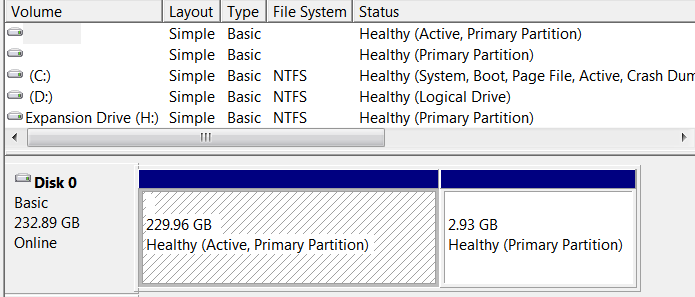

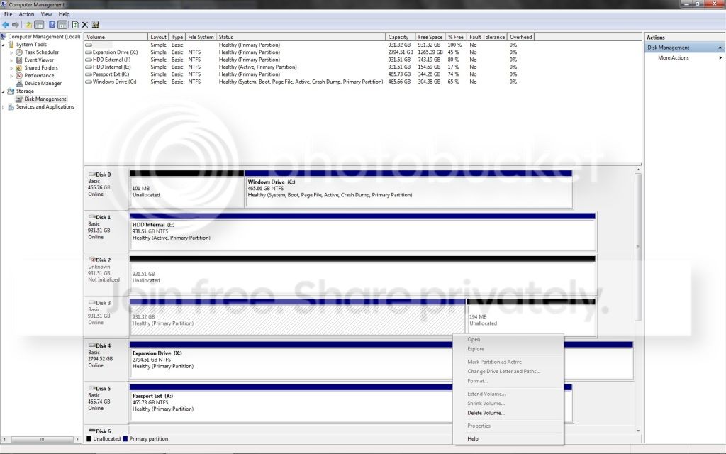

I am puzzled by the registry entries I have for mounted devices which I can change in line with the tutorial.
Here is my screen shot from Disk management showing option for changing "N".
Below are the mounted volumes. So far fine and consistent.
But the "mounted devices" in the registry include many unmounted devices except the unmounted (B, O, P, Q, R, W).
It also appears you can then make changes to unmounted device letters.
Can you shed any light on this?

Sure, if Windows uses the same letter for some commonly used unmounted devices (ex: USB flash drive) and has it listed in the registry as above, then you should be able to change the drive letter for it as well.

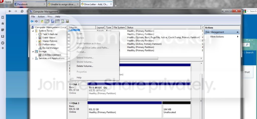

Hello Rythmeister,
Could you post a screenshot of your Disk Management window showing what it has for this drive? :)
Hello Rhythmeister,
Here you go Brink
The only options I have are "change to dynamic disk" or "offline" for that drive o_O

Rhythmeister,
Since this is an IDE HDD, double check to see if the jumper on the HDD is set to "master".
Afterwards, if the computer tries to boot to the IDE HDD instead of your Windows 7 HDD, then press the F key (usually F10 or F11) at boot to bring up the boot menu to be able to select the Windows 7 boot drive. Next, see if it has a drive letter, or if you can add one to it in Disk Manangement now.
I got it sussed Brink, it was a Ubuntu installation on that drive. I never considered the possibility of a different file system but fired the stuff onto an external drive from Ubuntu without issue!

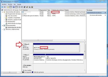

Hello Pedrornac, and welcome to Seven Forums.
Could you post a screenshot of your Disk Management window showing what it has for these drives?
Here.
The last two shows all the "grey" options.
Pedrornac,
By default, whatever OS you have started up in, it will show as the C: drive while in it.
You could use OPTION THREE in this tutorial with a elevated command prompt to add a drive letter to Disk 0 to it listed in the Computer window again.
I don't see the disk in the elevated command prompt
Pedrornac,
What do you have on Disk 0?
It's not showing that it had been formatted previously as NTFS, and that is why it's not showing up in the command prompt.
What do you mean by "disk 0" ?
The volume 0 in the elevated command prompt?
Sorry,
I meant Disco 0 in your screenshots of Disk Management in your other post above. It's the one not listed as a volume in the command prompt screenshot.
It's a disk with one NTFS partition. I use it for storage only. In my old win 7 installation and I can access it fine then. And still can access from a Ubuntu live cd.
That may be fine for Ubuntu, but for Windows 7 to be able to use Disco 0, it needs to be formated as either NTFS or FAT32 first. NTFS is preferred. If you format it, be sure to backup anything you do not want to lose to another location first with your Ubuntu live CD.
The disk is formated as NTFS, and I done that with a windows application.
