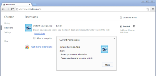

Please post a screenshot of the extension that you are having trouble getting rid of...
When I install the extension (inside a virtual machine), I see this:
The installation creates a scheduled task.
AdwCleaner does not remove that task nor the app that it calls.
The task re-installs the extension.
Do you have a scheduled task like that?
If so, disable it, but don't delete it - yet.
