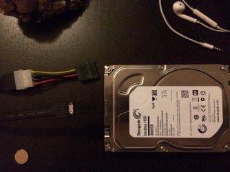

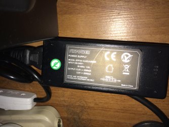

I use the ESATA/SATA cable + power supply combo, as follows:
