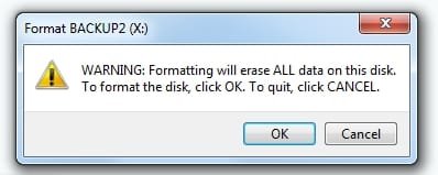

Question is there a prog that I can put on the HDD that will say something like "STOP do you really want to reformat this drive" if this happens again.
Apart from the warning windows gives:
Not that I know of. It isn't an issue for anyone else, as far as I can tell.

As far as I know I have never seen this format warning box for an HDD. I have seen it for formatting USB flash drives.

It is the normal windows warning box for formatting any drive.
