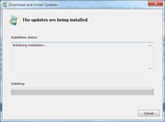

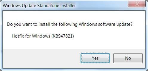

Hi Snick, thanks for responding to my thread.
As I have stated in this thread, I have run SFC repeatedly (usually with just the /VERIFYONLY option) and it always finds my system files intact. I also have run CHKDSK /F, which finds my system partition intact. I have tried to run SURT according to the posting rules for this forum, and it is truly weird. It asks it I want install <the update name>, I answer yes, it runs and finishes claiming success, but then I don't find the SURT program or anything else new to run: nothing new in the Programs list, no new desktop icons, etc. I click on "Windows6.1-KB947821-v34-x64.msu" that gets downloaded and I get the following screen:
If I answer No, it aborts. If I answer Yes, it runs for a long while with this screen showing
For some weird reason checksur.exe gets run off my F: USB-connected backup drive instead of from my C: Windows partition or my E: Winchester hard drive where "Windows6.1-KB947821-v34-x64.msu" is stored.
I'm running it now and will post all the logs when it finishes, as you requested.
