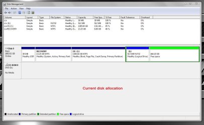

Hi everyone,
I'll start with a current image of my disk allocation and then give some background on what's been done and what I need to do from here.
I installed Windows 10 on my desktop and decided I hated it after the 30 day grace period. I used a system image to revert to Windows 7. I then installed Linux Mint 20.3 as a dual boot with Windows 7. Linux crashed in a spectacular way so I deleted it from its partition and changed boot settings using EasyBCD. Windows 7 works as it should and I won't be reinstalling Linux.
My question is regarding the FAT32 Logical partition next to the free space I gained when I deleted Linux. Does Windows 7 use that FAT32 partition for anything? The computer does have an optical drive and several USB ports if that's the reason it's there. If I need to keep that partition can I extend it into the free space but then shrink it back down so that I can extend the Recovery and OS partitions.
Thanks in advance for any help - I haven't messed around with disk allocation for 100 years and realize I can really brick this computer if I do something too stupid.
Jaye

No, your "E" volume is not used by Win 7 and serves no purpose. Get rid of it.
Currently, you have an Extended partition (the dark green border) encompassing the logical volume "E" and free space that is not assigned to any other partition or logical volume. (Note the distinction between "free space" and "unallocated space" -- they're not the same thing. In this case, the free space is technically not unallocated because it *is* allocated to the Extended partition.)
In front of the OS partition you have a tiny DellUtility partition (an artifact leftover from the XP era, and of virtually no use today) and a 13GB Recovery partition containing the Dell factory OS restore image. That Recovery partition is "System, Active", which means the OS is booting through that partition. (It's also not meant to be user-accessible, so there's no reason to try and expand it to a larger size.)
Technically, you don't need the first two partitions, either, because you have backup images you're using instead -- which is a much better plan than going all the way back to a factory restore, anyway. But if you alter either of the first two partitions you'll need to do a boot repair to the OS partition to get it booting again. That's not hard, but it depends on how much you want to tackle and how confident you are. If you want to discuss that we can go into further detail, but for the simplest resolution leave the first two partitions as is.
Delete the "E" logical volume, then delete the Extended partition. Once you have turned it back into "Unallocated" space, you can expand the OS partition to add that space to your "C" partition.

You should be able to explore the logical drive E under the My Computer icon. If there's nothing in it, then I'm going to hazard a guess it's not of any use. Especially if you just have Windows installed.
The software DiskGenius makes stuff like this easy, but for this, Windows can do it as well.
For future reference, I wouldn't use multiple partitions for anything. Especially dual OS installs. They're way too problematic, data failure can rear its ugly Predator-like head, and partitions can suddenly go *poof* and disappear like magician's flash paper. I'd use more than one hard drive for more than one OS and a 5.25 hard drive switch drive bay. I can't remember the manufacturer, but I know one to have a reportedly decent HDD switch 5.25 bay. If interested I can look it back up in my Amazon list.
Having said this, it's likely Linux crashed in a spectacular way because of this dual partition crap. If you're willing to give Linux a go again and this time using two hard drives instead of partitions, check out ZorinOS.

Windows can be installed in two ways: Legacy-MBR or UEFI-GPT
DON'T DELETE ANYTHING.
The Fat32 partition is used on a GPT drive to have the boot manager.
It seems that your drive is Legacy-MBR and not EFI-GPT as you have the recovery partition set as active.
What do you have on E: (the Fat32 partition)?
Please post another Disk Manager image with the column Status expanded so we can read it.

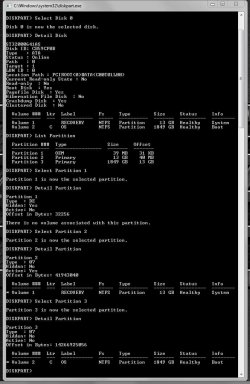

I hate to be a pain in your patootie, but I don't know how to show the column status expanded. I did a complete Diskpart with each partition (hope this helps):
The first partition was factory installed and I don't have any kind of access to it.
The second partition is Recovery and I think it's supposed to be active. I could be wrong.
The OS partition is not active, which doesn't sound right but the computer is operating normally.

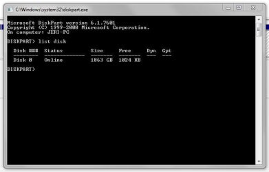

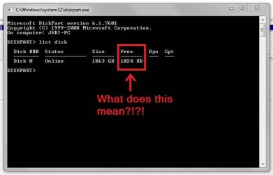

One more favor - could you look at this next image and tell me what's going on with "Free" in regards to the 0 disk?
Thanks!

Only strange thing I noticed is that the Recovery partition is set as active. Normally is the first one.
That was a very common Dell configuration as shipped from the factory.
A little history, for anyone who might be interested:
  • Dell added the "DellUtility" partition* (usually 39-60 MB) around the late-98 or ME era. It was always first on the disk because it ran DOS and DOS cannot boot beyond the first 2GB on the disk. It was shipped as "Active" but after first boot (termed "BTS" or "Break The Seal" by Dell) the OS partition thereafter became the Active partition.
  • Late in the XP-era Dell added a "DellRestore" factory restore partition* at the very end of the disk. The OS partition was still Active (post-BTS). DellRestore was never Active and was only booted by the proprietary Dell MBR when the magic factory restore keys (Ctrl-F11) were pressed.
  • In the Vista-era Dell used the newly-Microsoft standard Recovery partition, moved to between DellUtility and OS. However, OS was still Active post-BTS which meant Recovery booted through the OS partition when needed -- not a good plan because a hosed OS could prevent one from booting Recovery.
  • That shortcoming was remedied in the 7-era, in which Dell still used Vista's DellUtility/Recovery/OS layout but made Recovery the Active partition instead.
  • Late in the 7-era Dell finally dropped the DellUtility partition altogether. A DOS-bootable partition would be incompatible with GPT partition layouts, soon to be the coming standard in Win 8.
Also, FWIW, Microsoft MBRs could never boot logical volumes in the Extended partition. My understanding is linux could boot from the Extended partition (I'm not a linux expert), but that was something no Microsoft MBR was ever capable of doing. Noting that was the location of OP's FAT32 partition, it was clear to me it was not part of the Win 7 system.
