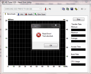

The HD Tune test of the encrypted SSD drive was even worse, it didn't even run:

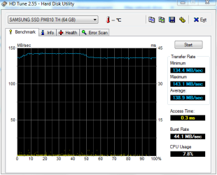

The HD Tune also showed something interesting, next to the fact that it actually ran:
The transfer rate didn't really changed much with BitLocker when compared to the non-encrypted SSD; however, the CPU utilization pretty much doubled.
