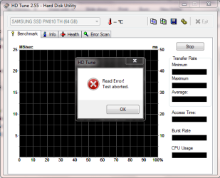

The HD Tune test of the encrypted SSD drive was even worse, it didn't even run:
This is the first time I've tested full disk encryption for an SSD drive and it is entirely possible that I've done something wrong. And no, I didn't mean encrypting the drive on the first place was wrong. As stated earlier, this is a laptop for an Enterprise where you don't have much of a choice.
So the question is...
Is it something which is normal with encrypted SSD drives and there are some tuning that can regain close to the original performance?
I'll do some more testing with HDD to see the performance hit with encryption, but I doubt that it'll be this bad.
