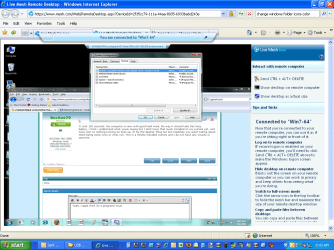

Yeah, I dont think its a programs issue.
As you can see from the screen shot, there are only a few items there, one of which, I just installed (spybot).

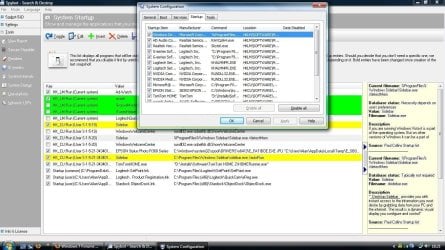

no no no what i meant was that spybot has a feature that shows you all the start-up items, A lot more than windows does and also gives full detailed descriptions of each start up items
In spybot you can sometimes find that what looks like 1 entry ie nvidia can actually be several items ie drive + control centre + physics and so on
what i was pointing out was that some start-up items can take over priority and even conflict important windows start-up items... this was the case with the very early days of vista with avast
see my attachment
