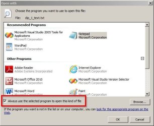

I missed a step! Check rhat "Always use this program...." is selected.
Other than that - you don't say the name the program that it reverts to as default.
Perhaps check that program's settings to see if there's a setting like "Always check that (name of program) is the default program for this type of file" or "Check on startup that this program....." or something similar.

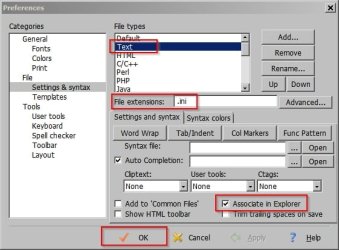

EP Settings

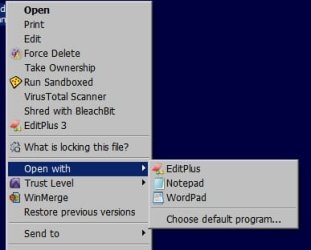

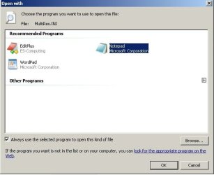

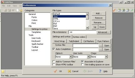

Okay so I downloaded the trial version and applying settings like this works:
For .ini files:
Then I see this when right clicking an .ini file:
And this when checking the default program:
It opens with EP by default with no further steps needed.

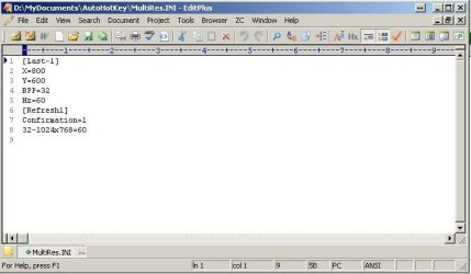

Following your example, I set EP type to .ini:
Then right click on in .ini file:
Then click on the EP icon to make sure that's the one to use:
Then enter brings it up in EP:
But, double clicking the file name brings it up in Notepad:
There's just something causing it to revert back to default of Notepad afterwards.

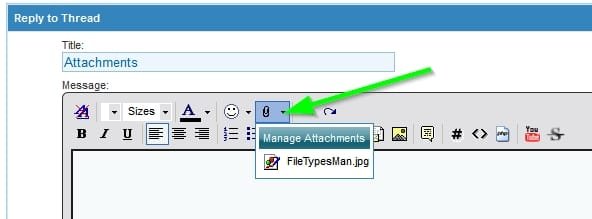

Removing an attachment:
Click as shown and choose "Manage Attachments"
In the window that open click "Remove"
To place an attachment to appear where you need it:
Click where you want to place it then click the attachment's file name.

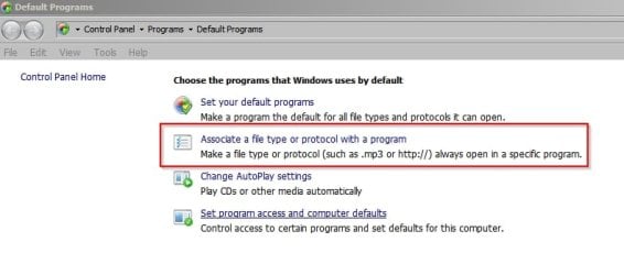

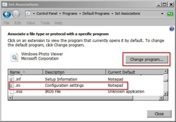

Let's try another method
Try START> Default Programs
Then select the following:
Scroll down to .ini and select Change Program
Select EditPlus and this time you should see that the "Always use this program" checkbox is greyed out. This is because the Set Associations control panel is used make system-wide file association changes.
Click OK
Post a reply here if it still doesn't work!
