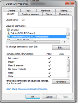

A few days ago I noticed a problem in my windows 7 computer. I wanted to download something from my browser and I got the following message, "You don't have the permission to save in this location. Contact the administrator to obtain permission."
However, I can download it by running the browser as administrator.
On spending some hours in finding and trying the solution, all the methods failed. I also tried the following method which was the most popular.
I went to the drive properties and in that, I went to security tab and then denied and allowed the permissions for administrator and users. I get the message that said that an error occurred while applying security information to some folder. It did not work.
However, I noticed something. In the control panel under user account and also in the start menu I could see my username and 'administrator' beneath the name. But when I went to the drive properties and then to security, I found a different name beside Administrators.
To see if it was some problem, I checked this in my laptop and found the username were same in both the places in my laptop except that the letters were in caps in the security tab in properties.
I have also posted the screenshots.
I think this is the problem.

ACL changes may still take place despite that error message.
Are you able to save to D drive without any problems?
If not, would you like to open a command prompt and post back the results of the below command,
icacls D:\
Windows 10, Windows 8.1 Pro, Windows 7 Profes...
Windows 10, Windows 8.1 Pro, Windows 7 Professional, OS X El Capitan
No, I am not able to download now also and it happens in other drive also.
Here is the result of CMD:
Microsoft Windows [Version 6.1.7601]
Copyright (c) 2009 Microsoft Corporation. All rights reserved.
C:\Windows\system32>icacls D:\
D:\ NT AUTHORITY\Authenticated Users: (OI)(CI)(F)
NT AUTHORITY\SYSTEM: (OI)(CI)(F)
DELL-PC\Daksh: (OI)(CI)(F)
BUILTIN\Administrators: (OI)(CI)(F)
BUILTIN\Users: (OI)(CI)(F)
Successfully processed 1 files; Failed processing 0 files

Dakshjain, could you go up to the folder D:\Songs, right-click it > Properties > Security (tab) > Advanced > Effective Permissions (tab) > Select..., type your user account name into the dialogue that pops up, then press OK.
Observe the Effective Permissions list for your user on this folder.
Now press Select... again and type "Administrators" into the dialogue, hit OK.
Compare this list with the one before. Are the lists the same? If they're not, could you post an image of both these lists.
No, there is no difference.

The lack of difference proves that you have exactly the same rights as the administrators group would for this folder.
I'm not sure why you are not able to save to this non-system folder location.
You can try things such as disabling UAC or disabling your firewall, and see if your browsers will let you save after that.
Also, it may be worth a try to grant the Everyone group an explicit full control permission to this folder with the command,
icacls "D:\Songs" /grant Everyone:F

The code that you posted worked!!
Thank you so much Pyprohly and lehnerus2000 :)
