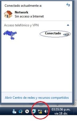

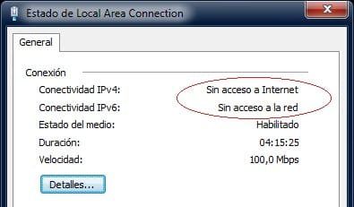

I've a problem that is quite similar. Internet is ok and connected but the network says "no internet access". This issue still remains after a restart..
Probably you're experiencing another problem as I do. When you set up a new broadboand connection (just say you wanna test it from scratch, just in case), Windows 7 tries but fails to connect to the internet. However, if I choose skip and create and then connect manually later it works normally, even tough the YELLOW TRIANGLE is always there, near the clock.
Please does anyone know how to fix this?? Thanks

Thanks for your quick reply. Indeed, I thought you had a virtualization software installed, WMware in this case. My point is these programs install another network driver. That's why you have 2 networks available. Back to your problem, I don't know the details but your modem may be configured as a router, so it's connected all the time.
Regarding my problem, by going to my Local Network properties, the IPv4 and IPv6 connectivities are down. But, with all of this, Internet works OK, browsers, p2p, etc. It's connected.
The following DID NOT WORK:
1-Power off and back on my modem
2-Restart, reinstall my network drivers
3-Checking hardware problem, like cable and phone line
4-Set up a new internet connection, with default options
