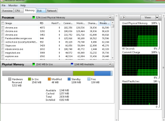

All ram not showing up?
8gbs and it makes this lastop scream it only shows 7.86 usable

8.00 GB ( 7.86 usable ) ? Totally normal.[/QUOTE]
8gbs 2.87 usable

You posted a screenshot of the Overview tab not the Memory tab.

Have you tried changing the slots in which the RAM is in? This has been the case, in similar situations like yours, the RAM arrangement may not be correct for your motherboard and therefore this may account for the large Hardware Reserved segment within Resource Monitor.
let me try that brb
let me try that brb

When hardware is using that much memory it usually mean the wrong ram or the ram is installed incorrectly or both. It must be done according to motherboard and cpu specs taken into consideration. With out specs I can not give you a answer about either one. The motherboard manual is also needed for proper instillation of ram. Look in the lower left and tick on My System Specs. You will see my system. That is what is needed for your computer. That is also wheir/where it needs to be. It will follow your every post. These are the things that need to be done for proper instructions to be given.
