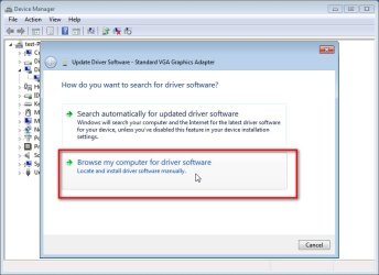

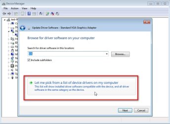

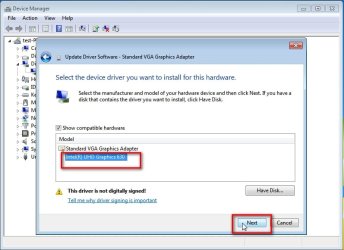

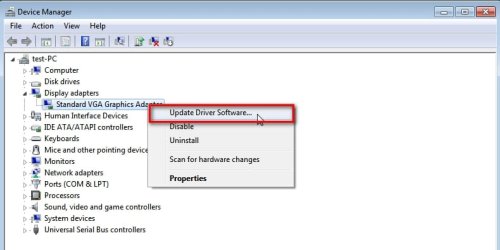

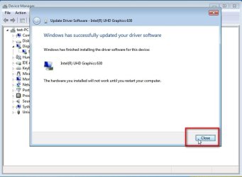

I was using your method. it couldn't work. yellow question mark when installing driver done.
my guess it's a PCIe bus conflict issue on PC motherboard (because NVMe, Graphics, WIFI all are PCIe devices). Just no proof.
It's no solution on Windows 7 level. but Microsoft offers I2C solution on Windows 8/8.1 or higher (10/11). Right like TouchPad issue of new modern laptop.

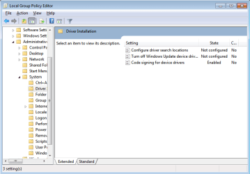

I followed the pdf file option#3 to install new drivers after reboot. however, warning sign still pop-up

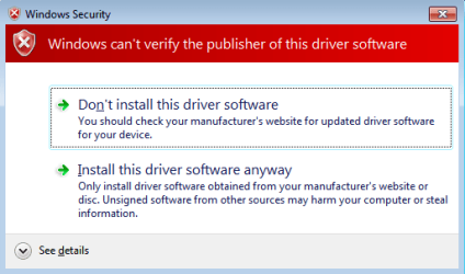

click "install this driver software anyway"
If the driver is not signed for that os, it asks your permission to install. It is normal.

I did, then got yellow mark when done.
the PC OS install no issue when 1. Windows 7 on SATA SSD. 2. Windows 11 on NVMe SSD. but see problems when Windows 7 on NVMe SSD.

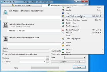

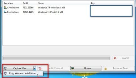

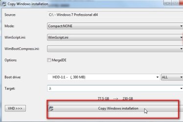

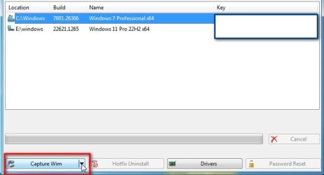

What method did you use to get win7 onto the nvme disk?
If you have the nvme updates in your win7 on the sata ssd, you could use Wincopy to copy the os partition from the sata ssd to another partition on the nvme disk and see if that does it.
WinNTSetup_v531a.rar
click the little blue icon at top right and select "local windows installations"
click the os you want to copy to highlight it in blue
then select "Copy Windows Installation"
click the litttle dropdown arrow on "Boot drive" and select the esp partition on the target disk ( in your case the esp partition on the nvme disk )
click the arrow on "Target drive" and select your new partition on the nvme disk
make sure MODE Compact:NONE
then just click the button "Copy Windows Installation"

It doesn't format the target , it copies, adjusts the osvolumevalue and creates a boot menu entry.
So you need to have a formatted target partition already.

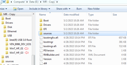

I cannot make a clone/image of this finished Windows 7 install. No tool working on it.
Macrium Reflect free version (V8), no USB 3/3.1 support. boot no problem. however, when under windows environment, USB keyboard/mouse are stopping working. I tested several times.
Then I added HP G1/G3 USB 3/3.1 driver, re-made Macrium Reflect. but still failed on HP G1/G3.
with a PS/2 mouse, I got HP G1 to run Macrium Reflect. ok to image/clone.
but HP G3 no PS/2 port. IMO, only solution is to add HP G3 USB 3/3.1 driver into Macrium Reflect free version.
Any suggestion how to do it correctly? my last test (adding driver to USB folder) was NOT working.
Should I add USB 3/3.1 driver into boot.wim of Macrium Reflect? According to Update your Win 7 installation media by SIW2, he actually added Windows 7 drivers into .wim of boot/install two files.
