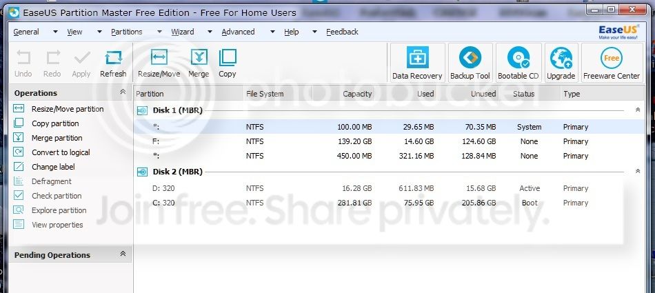

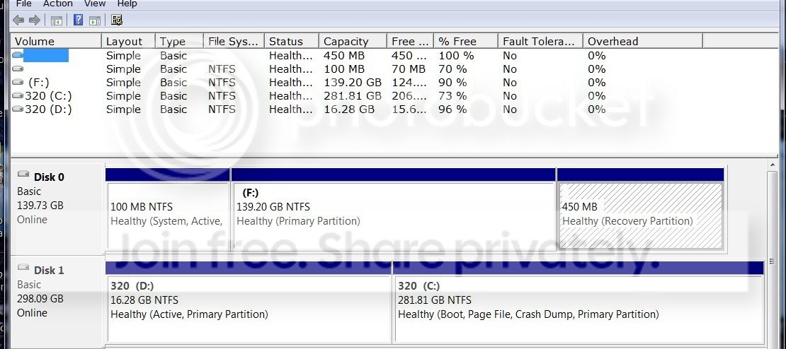

Here is the Disk config:

You said that the 300 GB Windows 7 will not boot however the disk management shot shows that it is the one presently booted, As signified by the Boot label. It is also being booted by the other hard drive as signified by the System label.
So is it F that is the other Windows 7 which will not boot? Or is it D which is incorrectly marked active? Only the system partition should be marked Active.
I asked if you wanted to keep both Windows 7 installs. Why do you need two? And own licenses for both? The f: (150gb HDD) is the new install so that I could bring up my 300gb HD which 1 has all of my info and HAS A BAD Boot sector which I need to repair and cannot.
So is it F that is the other Windows 7 which will not boot? NO Or is it D which is incorrectly marked active? D is the Boot partition that I am trying to fix, Only the system partition should be marked Active.

If D is the boot partition you are trying to save and make bootable, then mark D Active in Disk mgmt, power down to unplug the other hard drive, boot into the Windows 7 disc to run start up repair up to 3 separate times until D boots as C and wears the System label in Disk Mgmt.
If you've tried this then it likely failed due to the other drive being plugged in and interfering with it's system partition coming first in order. This is why it must be unplugged for the repair to be successful.
If too corrupted to repair then everything else possible is in http://www.sevenforums.com/tutorials/219533-troubleshooting-windows-7-failure-boot.html.

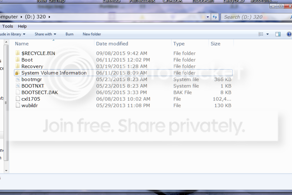

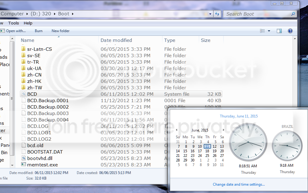

Check out the snap shots I took, pay close attention to the date and TIMES of the boot files, in most cases it does not change either date/time, and 1 is really funky, it is the snapshot with the clock visible.
Enjoy:
