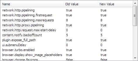

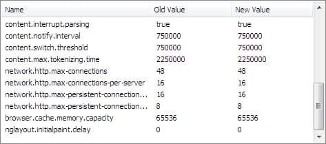

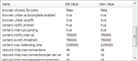

Right after the recent Silverlight upgrade from MS, my Netflix streaming videos would jerk (skip frames) every few seconds- most annoying.
What I did was change these settings in Firefox and it got rid of the jerking.
I have a relatively slow 1.5Mbps connection so your ideal settings may differ considerably.
The old and new settings appear to be the same because this shot is only to show the current settings:
