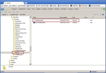

For me, T-Clock works only if run as administrator. However in order for it to run on startup it requires me to create an elevated shortcut to T-clock (clock.exe) in
%AppData%\Roaming\Microsoft\Windows\Start Menu\Programs\Startup
Without selecting the "run as administrator" option when creating the elevated shortcut.

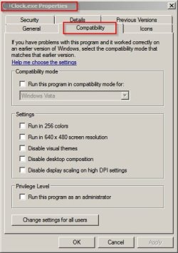

Im using the 64bit version. Here's screensots:
Ah, this is something I have not done.

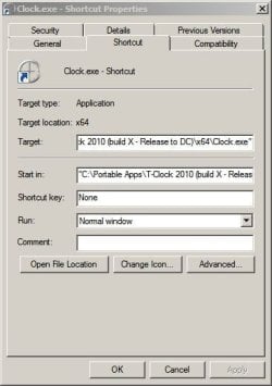

Okay here's a screenshot from my work machine - it's a different version og T-Clock to the one on my homne machine. Using a standard account.
Taget:
"C:\Portable Apps\T-Clock 2010 (build X - Release to DC)\x64\Clock.exe"
Start in:
"C:\Portable Apps\T-Clock 2010 (build X - Release to DC)\x64"
